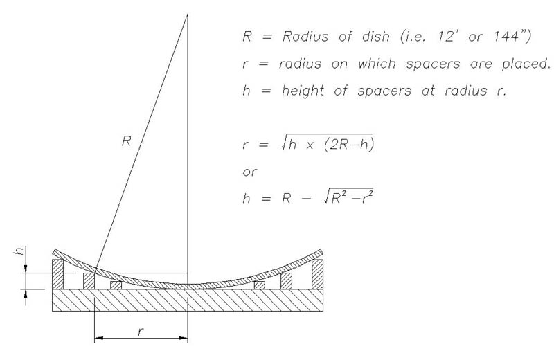

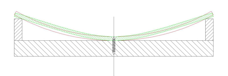

The formulae.

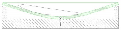

Difference between a radius and a spline curve (exaggerated).

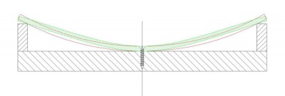

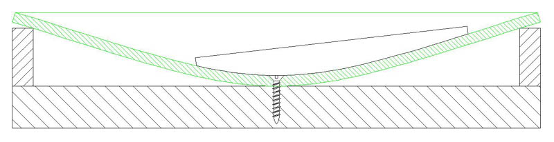

Theoretical problem with a spline dish (or parabolic or whatever the hell it is)

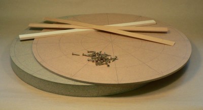

Raw matériels

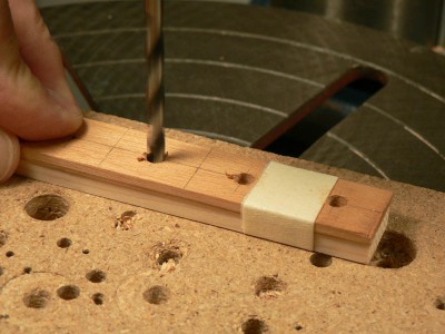

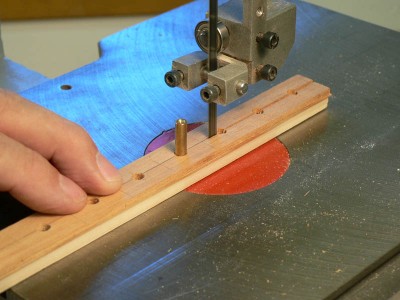

Drilling holes in the strips.

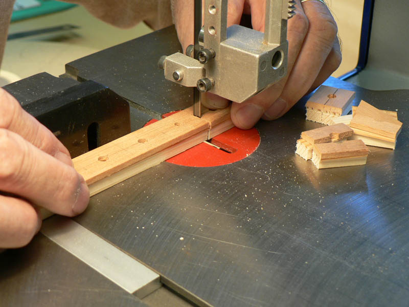

Cutting the strips in half (don't try to cut through the locating pin).
Cut the strips into pièces.

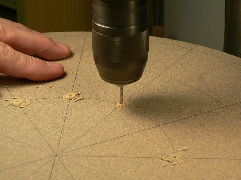

Drill pilot holes in the base board.

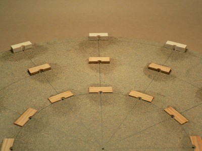

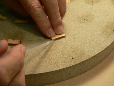

Glue the spacers to the board.
Dave Higham
Posts: 96
Re: Radius Dish Help
Postby Dave Higham » Fri Sep 01, 2017 1:27 pm
Spacers all glued.
