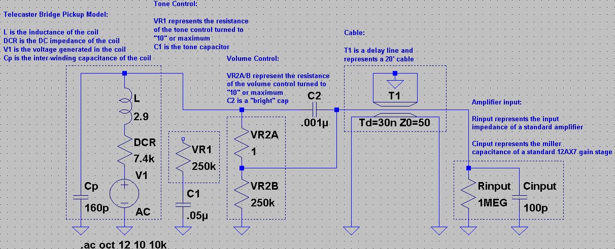

Ok, I've had a chance to simulate the frequency response of a pickup both with, and without a no-load tone pot.
I'm using LTSpice, available for free from the Linear Technologies website.
The model I'm using is that developed by Terry Downs, and is explained in detail on his website.
The circuit approximates the frequency response of a Telecaster bridge pickup, with standard 250k volume and tone pots, and includes a treble bypass cap on the volume control, which is fairly common. There is also a delay line to simulate a 20' cable, and the first stage of a tube amp.
You'll see that in one schematic, the tone control is connected as normal, while in the other, it is completely disconnected from the circuit, as would be the case with a no load pot.
The following are the standard circuit and frequency response:

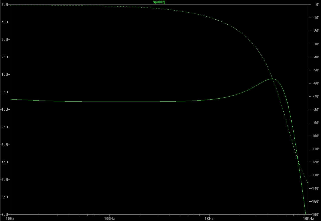

And here is the no-load circuit and frequency response:
- Greg Robinson
- Posts: 686
Re: 2 Single Coils, 4-way switch, with Phase
Both the frequency plots have been scaled the same.
You can see that with the no-load pot, it allows much more of the resonant peak through, around 5dB more! That's a much more significant difference than I was expecting. But, it doesn't do anything for the rest of the frequency range, and i might expect that it might tend towards a more nasal sound. It might turn out to be really good for lead work, but without actually trying it for myself, I'm undecided, this just goes to show that it does actually make a difference.
