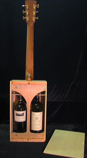

Randy Roberts flat top acoustic wine box guitar [Pictures] - created 03-28-2010
Roberts, Randy - 03/28/2010.17:35:23

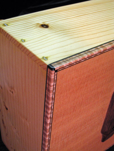

This was made for a friend who owns a wine store.
Roberts, Randy - 03/28/2010.17:36:21
It was made from a 2 bottle wine box, and I replaced the top with a reject broken Martin top. Neck was also a reject.

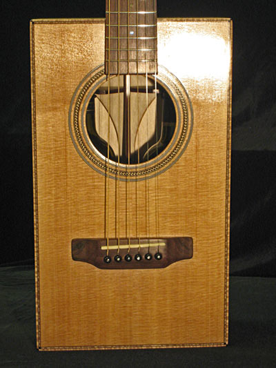

Roberts, Randy - 03/28/2010.17:36:57
I bound it with some leftover from a previous guitar

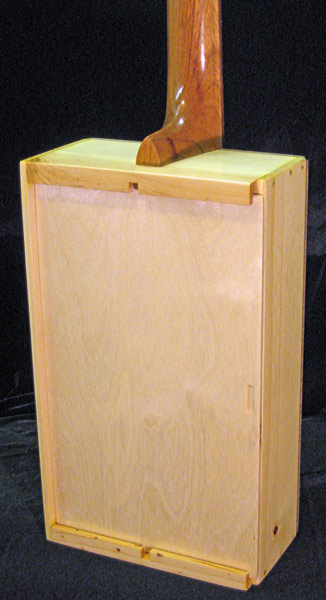

Roberts, Randy - 03/28/2010.17:37:54
View from the back

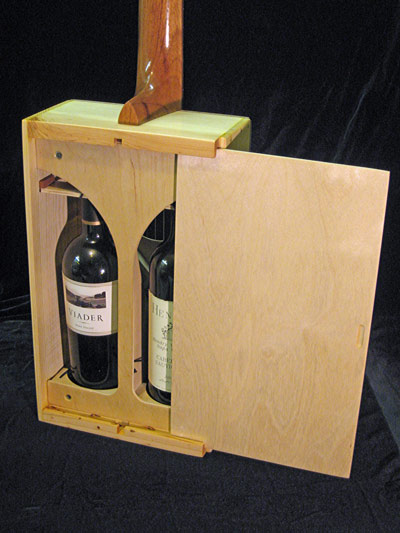

Roberts, Randy - 03/28/2010.17:38:25
The back was reinforced structurally so the original sliding back could still be used to place and remove 2 bottles of wine

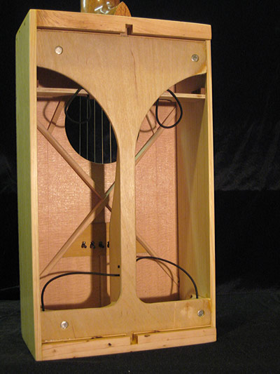

Roberts, Randy - 03/28/2010.17:39:07
View of the whole back. There are 4 sets of magnets that hold the sliding back and keep it from rattling.
Roberts, Randy - 03/28/2010.17:39:49
The back empty, showing the bracing, back reinforcement, wooden racks for the wine bottles, and the bungi cords that keep the bottles from banging around.

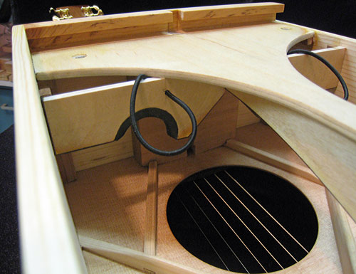

Roberts, Randy - 03/28/2010.17:40:32
Close up of the bottom bottle cradle
Roberts, Randy - 03/28/2010.17:41:07
Close up of neck cradle
Roberts, Randy - 03/28/2010.17:42:01
Of course the peghead had to carry the theme (supposed to be a bunch of grapes)

Roberts, Randy - 03/29/2010.23:02:28
Darrel & Arturo,
It actually has suprised me with how much this ended up sounding nearly like a regular guitar... Not much for the low end, but a fairly full midrange and high end nearly the same as a (cheap)guitar. There are very noticable differences with and without the bottles in it as would be expected. the really dramatic thing is when you take the sliding back off and on. Not much difference volume wise but pretty blah thin sound with it off, and dramatic change in the fullness and richness when it is on. Really shows how much the back and air cavity of a guitar contributes to the voice you hear.
A fear I carried through the whole project was that, with my luck, this would be the best sounding guitar I'd built yet. Fortunately it isn't. Isn't the worst though either.
Steve,
The inlay was considerably more interesting in conception than in execution. If you only could have seen what I saw in my mind before my hands got in the way . You need to imagine the moon is in the upper left hand corner out of the picture shining on the grapes. If you sit back a ways, squint until it blurs a little bit, and empty at least one of the bottles, you have a chance of seeing what I intended.
Chuck,
I don't know what he plans to do with it, he doesn't play guitar either. This was kind of a case of not thinking before I opened my mouth and saying "give me a couple of those wine boxes and I'll make you a guitar out of them". He said ok before I had a chance to realize what a waste of time it would be. But once started, I couldn't let go. I tried to weasel it into the $100 challenge but It was started too soon, finished too late, ran a couple dollars over, and dropped off the post from lack of progress and postings. (I might be able to claim the only triple DQ of the challenge.)
