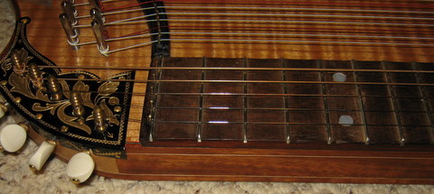

Schultz, Charlie - 06/15/2011.07:09:12
Atlanta
Another shot of the fretboard. Had trouble getting the fret slots wide enough for the bar stock as I did not have a fret saw with that wide a kerf. I used epoxy to ensure the frets stay in, maybe that was overkill.

Senseney, Steve - 06/15/2011.08:05:19
That looks really well done.
Is it easy to play?
Where did you get the bar stock material?
Schultz, Charlie - 06/15/2011.08:11:56
Atlanta
Thanks Steve. I haven't really played it yet- the strings are still stretching and I'm waiting for a "thumb ring" I've ordered. I do have a couple beginners zither books though.
I got the bar fret stock from LMI.
Senseney, Steve - 06/15/2011.08:25:45
I didn't realize it was available through LMII.
